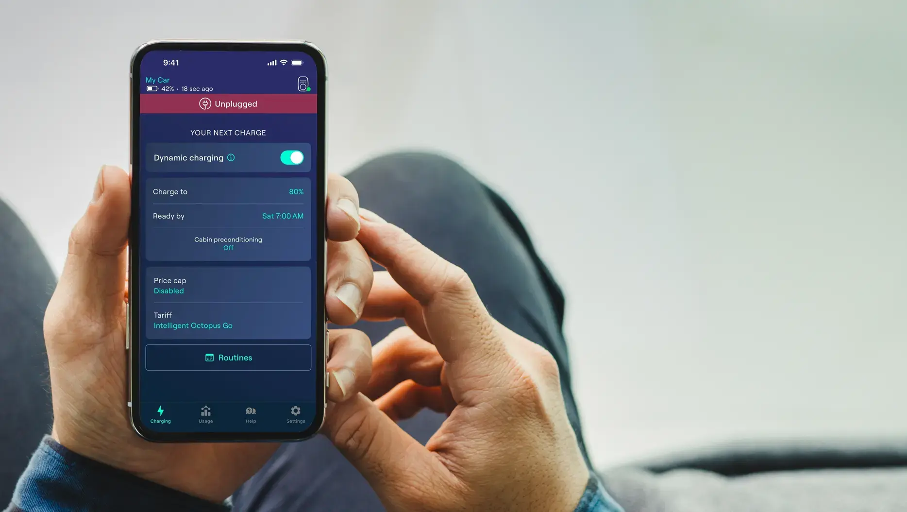

I have been reading this post with some interest
Looking at the OHME site, I found this
Apologies if this has already been reviewed by those who have Octopus as their supplier
